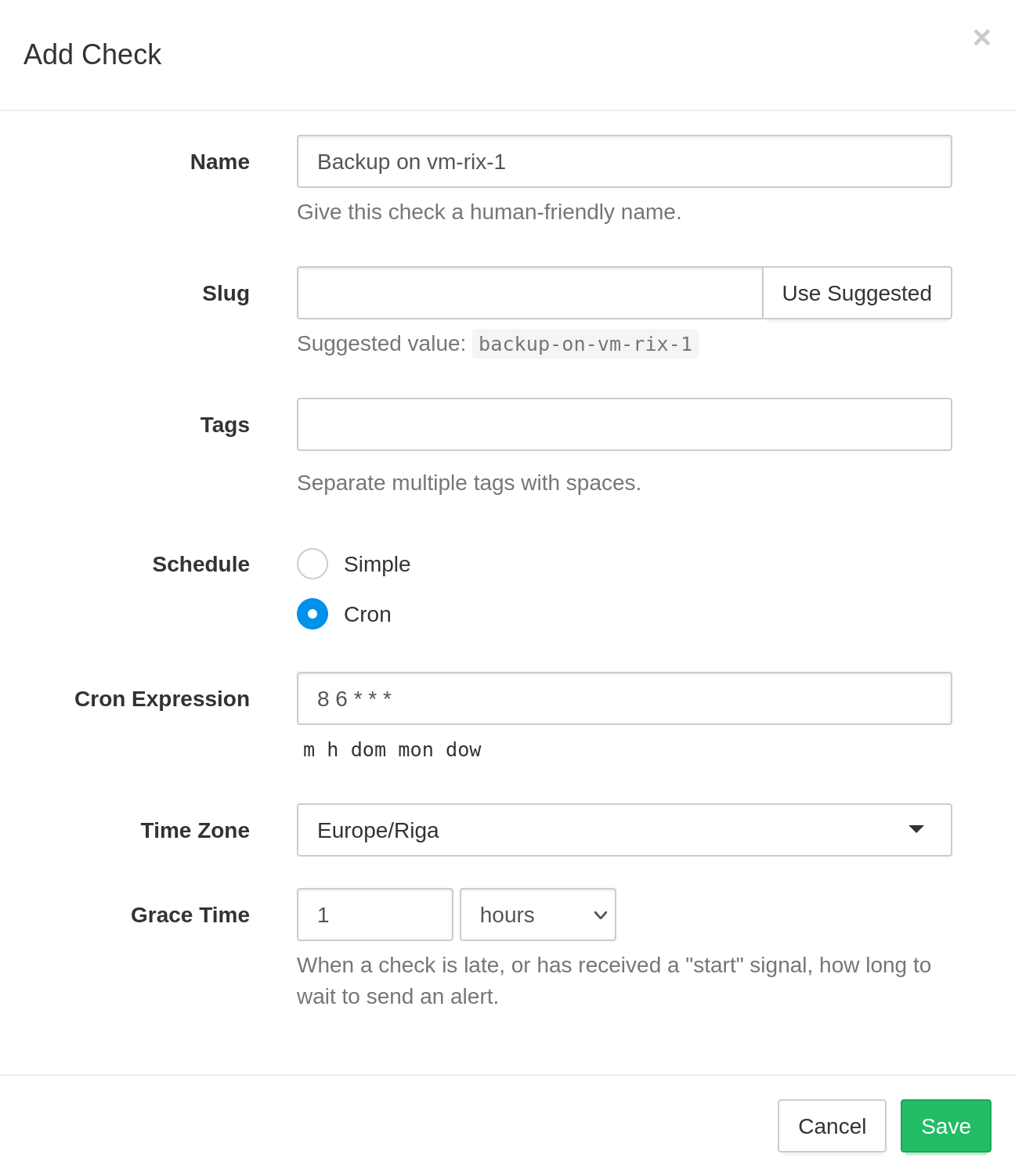

To monitor it, first create a new Check in your BigBearCronMonitoring account:
After creating the check, copy the generated ping URL , and update the job's definition:

/home/me/backup.sh exits with an exit code 0.Grace Time is the amount of extra time to wait when a cron job is running late before declaring it as down. Set Grace Time to be above the expected duration of your cron job.
For example, let's say the cron job starts at 14:00 every day and takes between 15 and 25 minutes to complete. The grace time is set to 30 minutes. In this scenario, BigBearCronMonitoring will expect a ping to arrive at 14:00 but will not send any alerts yet. If there is no ping by 14:30, it will declare the job failed and send alerts.
