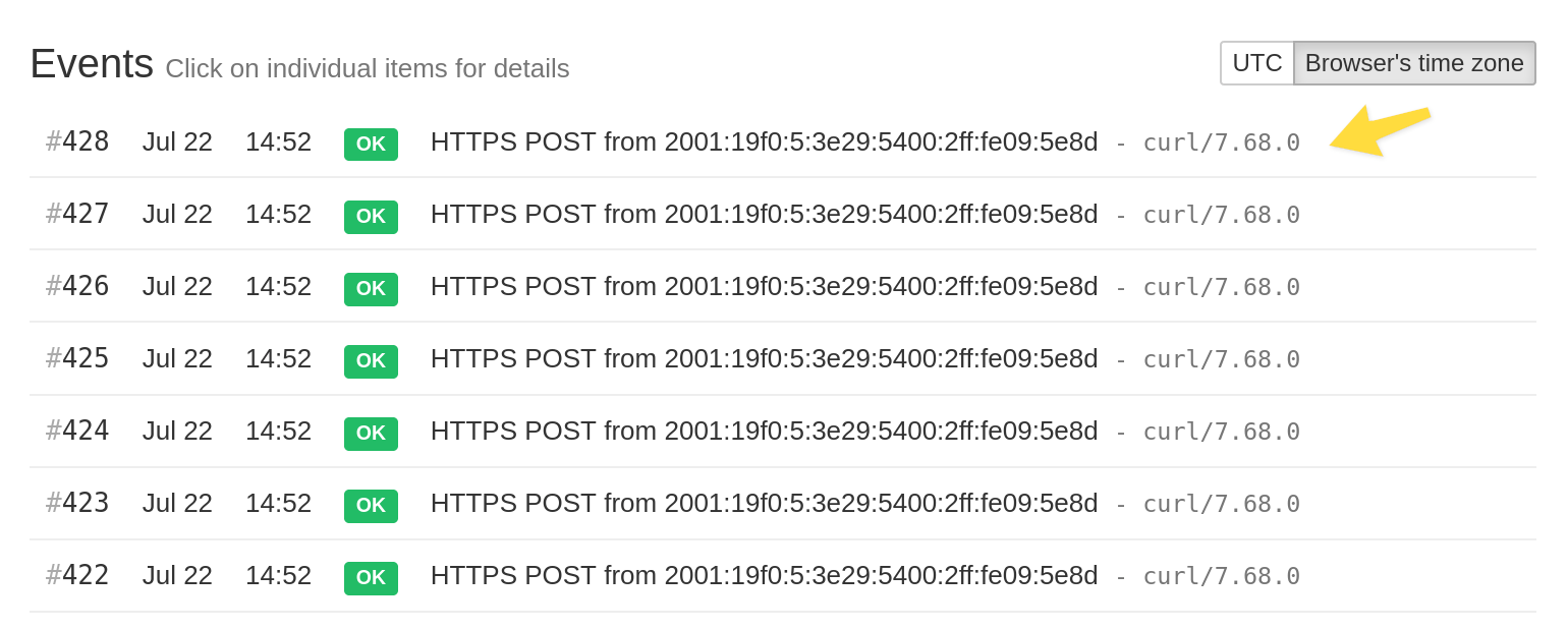

In the check's details page, Events section, click on individual events to see full event details, including the captured log information.
The Events section

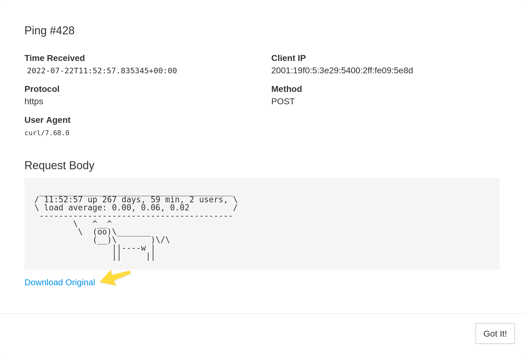

In the dialog that opens, use the "Download Original" link to download the request body data, exactly as it was submitted to BigBearCronMonitoring:
The Ping Details dialog
